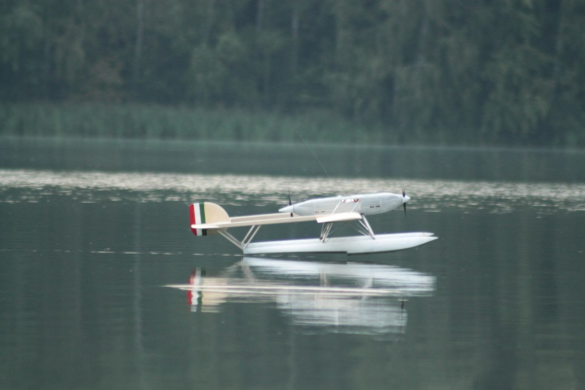

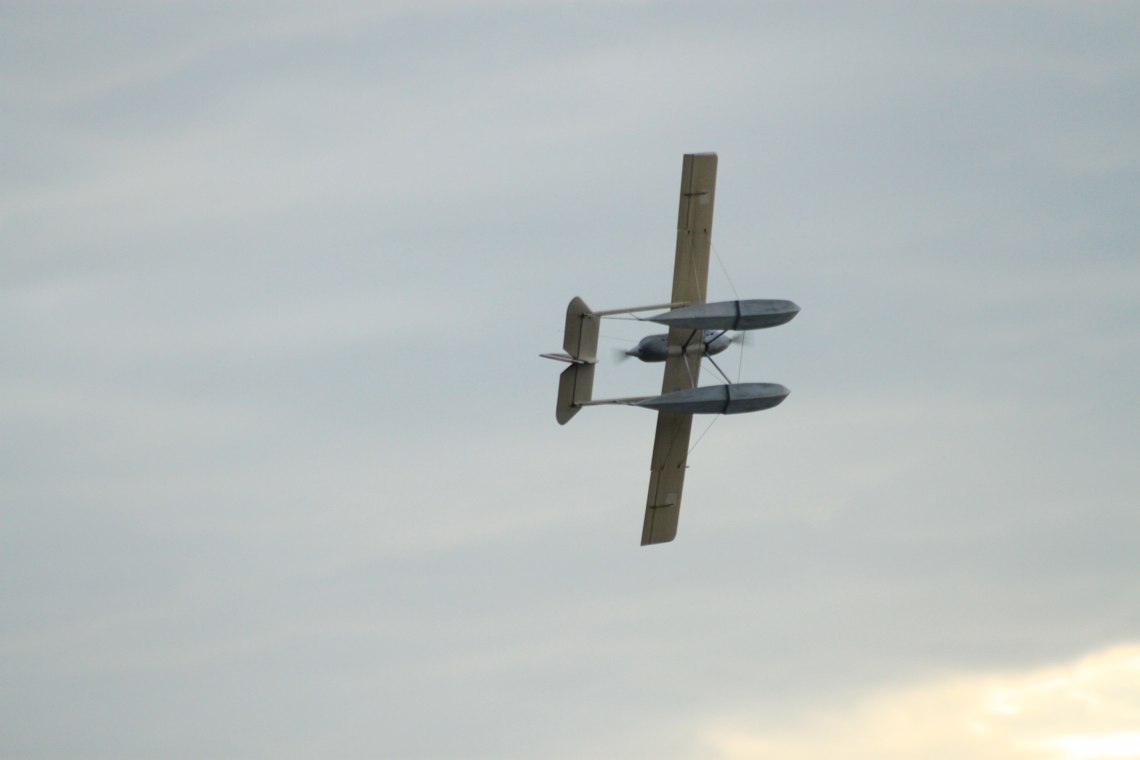

Hi all,
my own Savoia S.65 has recently taken to the air.
Some facts: 4485g flying weight, 165cm span, 2 Kontronik Kora 25 motors, one -13 wound and one -12 wound with thicker copper than stock factory wound. Battery is a 6S 4400mah, ESC two Schulze Future Value 60A-types.
And here are some pictures:
I have done 4 flights that day, and will make some more the next weeks. Painting will start over the winter month's.
Regards,
Rene
Kuni

Postby BillG » Mon Sep 05, 2011 4:06 am
Beautiful! The S.65 is a challenging model from what I understand. Quite an accomplishment to build a good flying one.

Postby Kuni » Sun Feb 26, 2012 2:47 pm
Hi all,
attached is a link to a late-fall-flying of my own Savoia S.65.
http://www.rcmovie.de/video/1e54d64308b ... avoia-S-65
Bill, the S.65 isn't tricky to fly, but you have to be watchful regards CG: the model flies fine even with a back-shifted (and trimmed-out) CG, but tends to dive then; it is hard to re-establish control. Also it tends to do this in hard-flown corners. Otherwise flying with a back-CG is quite fine.
At the moment I am giving her a coat of paint and some detail...
Regards,
Rene
Kuni
