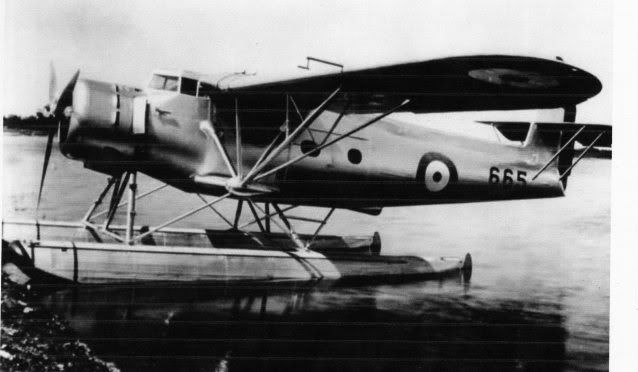

Postby TASSE » Fri Sep 18, 2009 9:03 pm
I would like to know more about this aircraft.
Thanks, TASSE.

Re: Fairchild Super 71.
Postby TASSE » Sat Sep 19, 2009 7:51 pm
Thank you Mr W.
I always thought that this aircraft would make a great flying model at, say, 1/4 scale. but what put me off was the small fin and rudder,although i have not read anything that tells of problems with the real aircraft.
Here is a 3 view thanks to Mr Widgeon.
And a photo of it as it is today,highly restored in the museum.
The Super 71p was the military version with the cockpit up-front and the wing faired in to the top of the fuselage.
