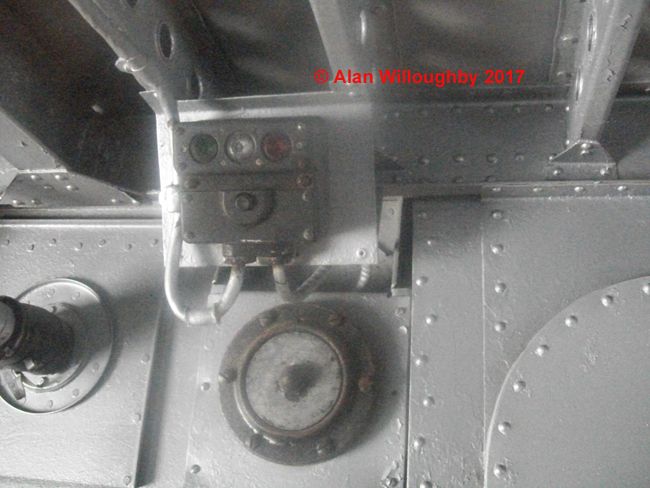

The call lamp was actually used to signal the crew at various stations (Wireless/Galley etc) along with a warning horn as in this photo here of mine (Galley)
If for some rhyme or reason the intercom did go out, the crew would either use hand signals or verbal communication.
