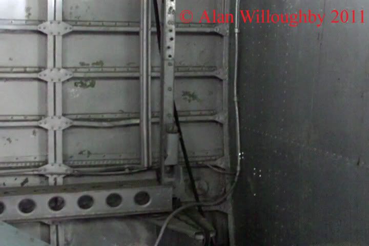

The carriage has a chain pulley system that allows the carriage it self to be raised or lowered
Generally Sunderlands carried x8 250 lb DC's but they could carry 400 lb DC's also, but only
x4 would be carried and they were kept stationed out side the aircraft.
When the pilot began his attack, he pressed a button in the cockpit which fired a solenoid,
which then caused some bungy/pully cords to drop the bomb bay doors down and at the same
time as the doors dropped the carriages moved out under the wings.
Photo of Bungy cord

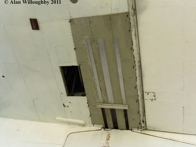

The wings had three tracks, which had thin aluminum strips which rolled back nito
the wing as the carriage moved out. (Note The twin tracks on the Airfix Sunderland are wrong)
This photo shows the track strip partially closed/or open (depending on your way of thinking..)
Note the doors could not close while the carriages are out (modelling tip).

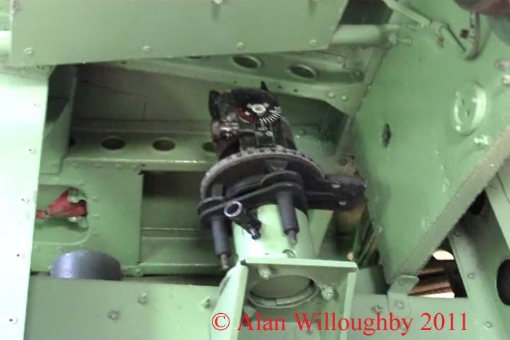

The pilot could also preset the bomb delivery by using a Clockwork device
called the "Mickey Mouse", I have seen one of these in action, it's would up and
when the stop is realeased the contact arm moves across face the and as it touches
a preset contact the DC's would be released
Photo of Mickey Mouse
