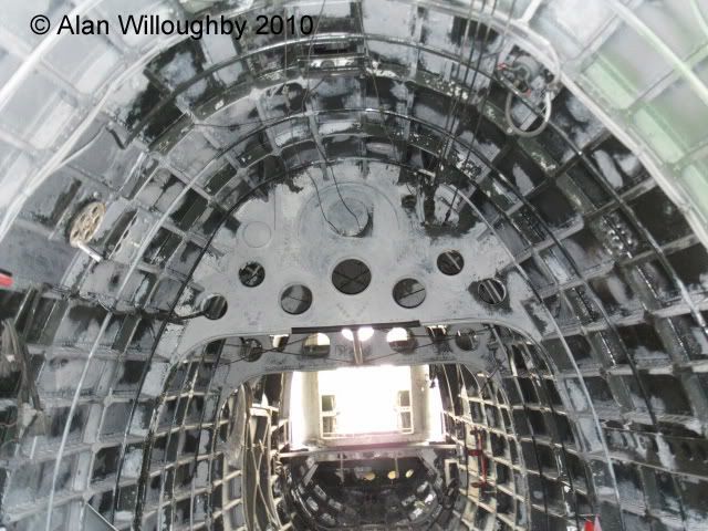

Hi All
Quick couple of questions as per above.
1)
Does anyone have a photo(s) of the enlisted crew bunks (aft of bomb bay) for a Mk III
and if the were on the rear deck near the rear hatch as per model photo.
2) Does anyone have a photo(s) showing a canvas wind break to cover
the rear stern bulkhead as in photo?
I have an exploded diagram showing these but not sure how
accurate they are in real life.
Thanks

Re: Sunderland Mk III crew ward room/Stern Bulkhead
Postby Pondskater » Tue Sep 14, 2010 9:09 pm
Honestly Alan, why can't you build a MkV like a normal person - or even go for a Mk I - there's loads of pics inside those!
Mk IIIs were not well photographed. The commonly available stuff are launch & early photos of the MkI or post war MkV pics.
But good news, scrabbling around I've found a couple.
First is this, from a MkIII with the Norwegian Air Force in UK waters. Cropped to give detail, from the rear of the workbench looking forward - I think there might be a bunk down by the two windows.
Then Short Bros took a few pics inside DD834 before she was converted to a Sandringham for Dodero.
This one is much more conclusive
And looking to the rear, is this the canvas screen you wanted to see?
Hope that helps.
I've enjoyed following your build - keep us posted with the progress.
AllanK
Pondskater

Postby sunderlandmr5 » Wed Sep 15, 2010 4:48 am
Hi Allan
Thanks for your reply... Yeah I can't do anything
by halves :lol:
I do have plans to build a Mk V later (an RNZAF one) :D :D
That photo of the canvas cover is excellent thank you,
it's more how I pictured it, and not what is shown
in the drawings I have ( which I think are some what fictitious anyway).
I knew one had to exist because of the canvas one over the rear bulkhead
behind the bomb bay, which was rolled up when in flight (especially if
the bomb bay doors were open) so I assumed the same for the rear canvas too
Thanks
