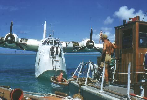

The tender would more than likely be an RAF one. when it arrived, the tender crew would throw ropes
to the Sunderland crew on top of the aircraft, which the refuelling hoses were tied to.
The Sunderland crew would haul up the fuel hoses and depending on where, either pump the fuel
directly into the wing tanks, OR use large metal funnels with Chamois inserted as a filter.
This is a photo of a RNZAF Sunderland being refuelled note tender and fuel hose
Another photo showing refuelling an RNZAF Sunderland, note tender moored with hoses to top of wings.
Note also on the starboard wing, the leading edge opening (closest to fuselage) is the APU (Aux Power unit)
which can be used to pump the fuel around the different tanks. The same can be done to empty the tanks
prior to the aircraft being beached.

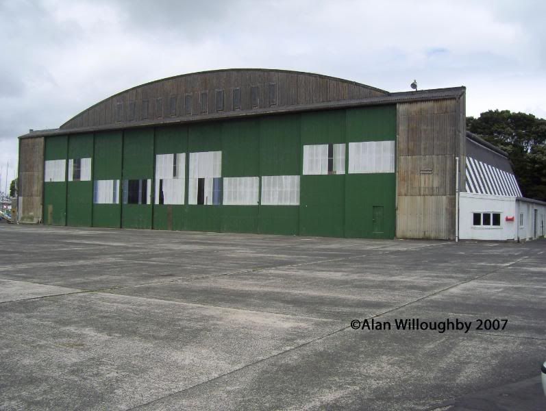

I grew up on RNZAF base Hobsonville here in Auckland, my Father serving with 5 Squadron on Sunderlands
Hanger and hard area
Slipway
