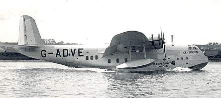

Picture of Centurion taxiing in on the Medway after her first flight, May 1937.
I’d love to find out more about what this particular plane did – to put together this short, but interesting, life.
