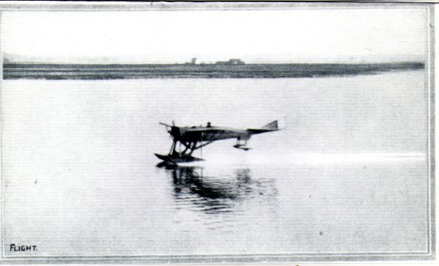

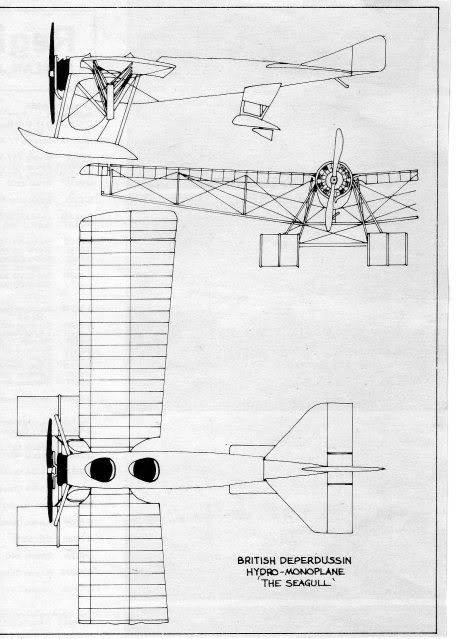

The British Deperdussin Company was founded in 1913 and was employing F. Koolhoven as adviser.
As far as i can find out only one seaplane was built. It was flown at Osea Island, Essex by yet another Anglo/Irishman Commander Porte of Felixstow fame.
A photo of it taking off.
The strange bracing under the wings caries the wing tip control.
